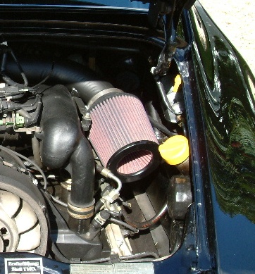

One of my cars was recently dynod at 312 bhp and this is a picture of its air filter setup. Obviously power comes from a few other goodies as well.
The reason you lose power is because of what sort of air is being drawn in. The basic air filter cover has an extended trunk that pokes out into nice cool air from the air inlet from the engine lid. A drilled airbox can draw air from the considerably hotter air around the engine bay. The cooler the intake charge the greater the power and vice versa. This is why some aftermarket filters can actually decrease power rather than do as they claim. Several people have done independant tests on various filter mods and options and have found the above to be true. The air box mod on it's own should be best described as a way of increasing intake noise rather than a performance mod on it's own. Think of it this way, you can make a funnel as wide as you like at the top but you can only get more out if you widen the hole at the bottom. So more air in and no increase in exhaust flow means very little worthwhile change.
Totally understand on the first point Laurence. However is the standard setup (picture attached) really getting that much colder air than say the setup I previously posted? The rear wing should be flooding the top of the engine bay compartment with cool fresh air.
