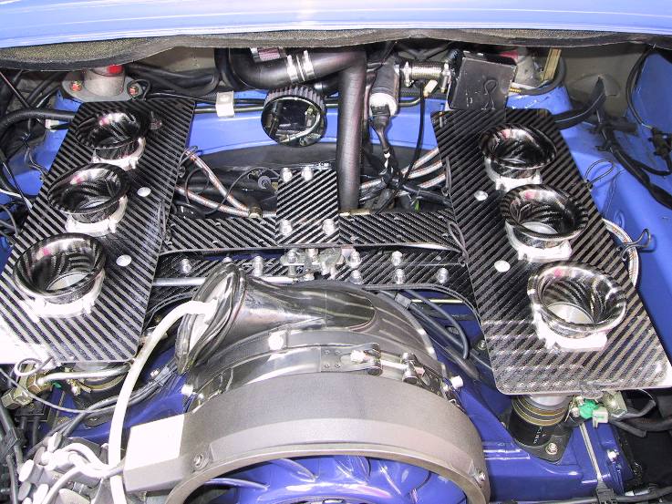

My only original point was that I couldn't see how allowing the engine to suck more air would reduce power. Based on the 2 pictures I've posted if you go from standard to the mod shown and do nothing else then you are right in that it may not produce more power, but I fail to see how it would lose power. I've called Adrian and left a message and I'll let you know what he says. The way I see it the mod just removes one of the many potential restrictions of allowing the engine to suck in the required amount of air. I guess the next restriction on the way to the engine is the throttle body and after that the science of a correctly designed manifold to achieve the optimum air velocity is key. If you flow more air / fuel to produce more power without modifying the exhaust then I guess you will build a higher pressure in the exhaust system. I admit I have no idea what effect this will have. I still say its not as simple as that, just my opinion.

If opening it up makes the pulses more stop start and as suggested less power I'm not sure why the setup attached works. You don't get more OPEN than this. This is Adrian Palmers induction system. Good for 400bhp normally aspirated and having driven it can say it sounds awesome, and goes a bit too.
Coming back to the original idea that you must do something to the exhaust if you open up the air filter restriction I'm willing to bet that if you bolt this lot onto a standard car accompanied with a remapped ecu you would still get great results without touching the exhaust.
The secret here is that they don't all use the same inlet pipe, so they don't share the stop/start pulses, which is where the problem comes in.
