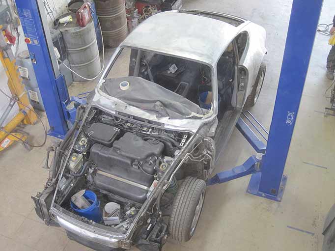

Dropped off in November and getting there at last. A typical case of 'let's see what we can find' and six months later I'm still there! Been told all bodywork repairs and new custom sections made, welded in and done, all rubbed down. Etch primer next week...
All stripped down and back to bare metal. Was going to soda blast everything to original base coat but discovered there were too many later paint layers (with no primer on some panels) so far quicker and cheaper to sand back.

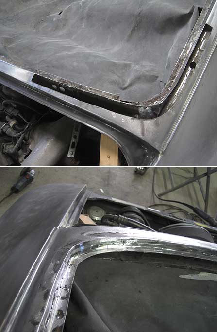

Rear window and corner corrosion which explains water ingress to the floor (front and rear) that I had. New templates and custom sections done.

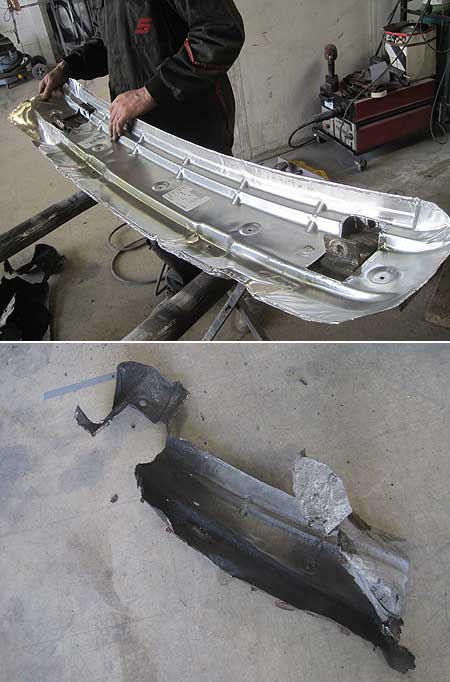

I've just repaired all the rear bumper heatshields.
It's amazing what you can do with a sheet of 0.9 mm aluminium which is thin enough to cut with a strong pair of scissors, a pop riveter and rolls of aluminium adhesive tape.
