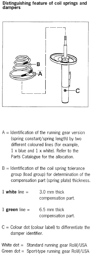

The paint dot colours are listed in the PET. You can download a copy from here: http://www.porsche.com/uk/accessoriesandservice/porscheservice/originalparts/originalpartscatalogue/
steveoz32
part 996 343 531 01 504 = blue / yellow
part 996 343 531 15 504 = brown / white
Identification on MO30 should be green and white. for coupe, green and red for cabriolet.
The other is x74 as you mentioned.
I'm assuming then that the orange is a faded brown, so I have 996.343.531.15.504?

http://cgi.ebay.de/Porsche-996-Carrera-2-Komplettfahrwerk-neuw-/270714907606
Shock cases / struts have orange / brown on them same as mine I assume, bottom of springs are same colour, but the blue dot at the top is green on mine......
Confused! Was going to get the MO30 kit, but before that I decided I would make sure I don't have any of it already fitted.

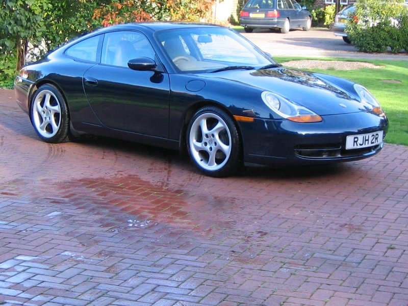

Looking at those pictures of yours, I'm not sure now. Here's a pic of my old C2 with M030:

Richard, I'm not sure either, looking at yours I thought it looked lower, then going back to mine I wasn't so sure.

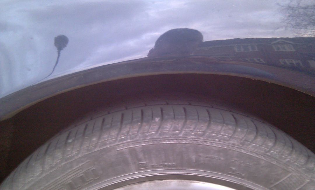

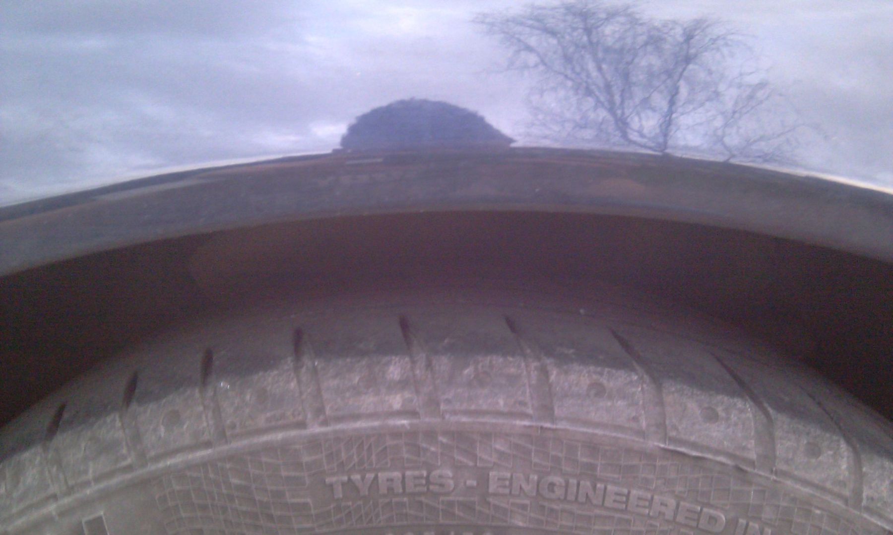

Is there a way to measure clearence perhaps? putting a flat strip of metal on top of the tyre, in the centre all the way to the back of the arch and pressing on the middle of the tyre reveals I have 44mm of clearence at the back from the tyre, both front and rear tyres are pretty much new (only 2k on them) and 43 at the front.

P.S, did you have spacers on that? The turbo look wheels seem further out than mine which may affect the look.

No, mine didn't have spacers.

I thought the m030 kit only dropped the car by 15 mil? When i photo mine ill put a rule next to it and measure the clearance.
Front 44 mil.

I've got pretty new tyres on though. I just re-measured, came up with aprox 47mm rear and 45mm front.
It would seem that mine is about the ride height of MO30, now whether that is through wear or that the springs were changed at some point I don't know.
