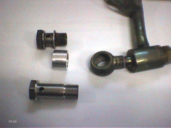

I can see it, can you take a pic of the exhaust side. Whoever had a go at that water pipe should step away from the welder.
That badly welded coolant hose reminds me of how we resolved mine, the top bolt is the standard fitting the lower longer one my brother machined for me with the spacer (center) so that the turbo coolant pipe cleared the larger turbo.

Neat idea with spacer! Did you have copper washers iether side?

I think you'll have to speak to the man himself, catch him right and he'll look after you. Re the water pipe, I've read people have heated it up and bent to clear the turbo. The banjo is probably brazed in , so don't melt the braze.

Think it was ally washers originally so just used one ally and the ally spacer
