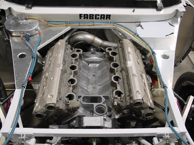

Depending on the sump arrangement of the alternative motors. I know our sumps are pretty deep and if you go to a dry sump system on a 944, you can lower the motor by quite a few inches. Not sure how this could be utilised in fitting an Audi motor but where there is a will there is a way. One thing I really don't like are those modified bonnets to allow for larger or upright motors. That really makes the car look too American.
Having said all this, I'm sure I've seen pictures of a 944 with a 6 cylinder Porsche engine in the front. It was really weird looking but someone did it and apparently it was pretty damn quick.
Oh, just to show that nothing is impossible. Here's a 928 motor in a 944 race car. Nothing stock about the frame, but it can be done.
