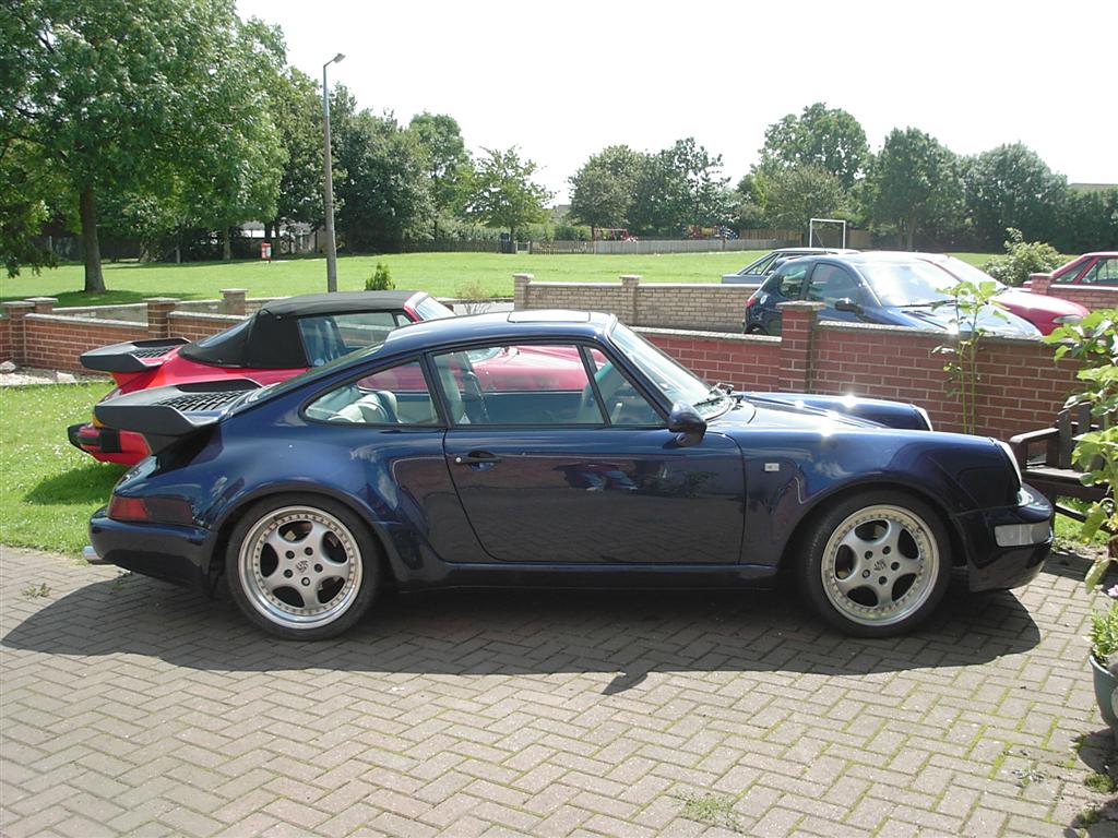

Well I've done it, Iv'e got my trusty targa going in to have the rusty sills done, but you know it just doesn't stop there. oh no.
As we walked around the car me and the paint shop owner came to the conclusion that the only part of the car that wouldn't benefit from being repainted was the rear spoiler but then we noticed a small scratch on that as well!
So now the whole car is being stripped back to bare metal and the pair of rusty sills and B posts replaced and we also decided to replace the nearside front wing as that has some rust bubbles appearing under the headlight, phew
The paintshop guy asked me if I would like to source my own panels as he thought I my be able to get them at a better price than him,for example the new front wing he can get for around £600 from Porsche.
