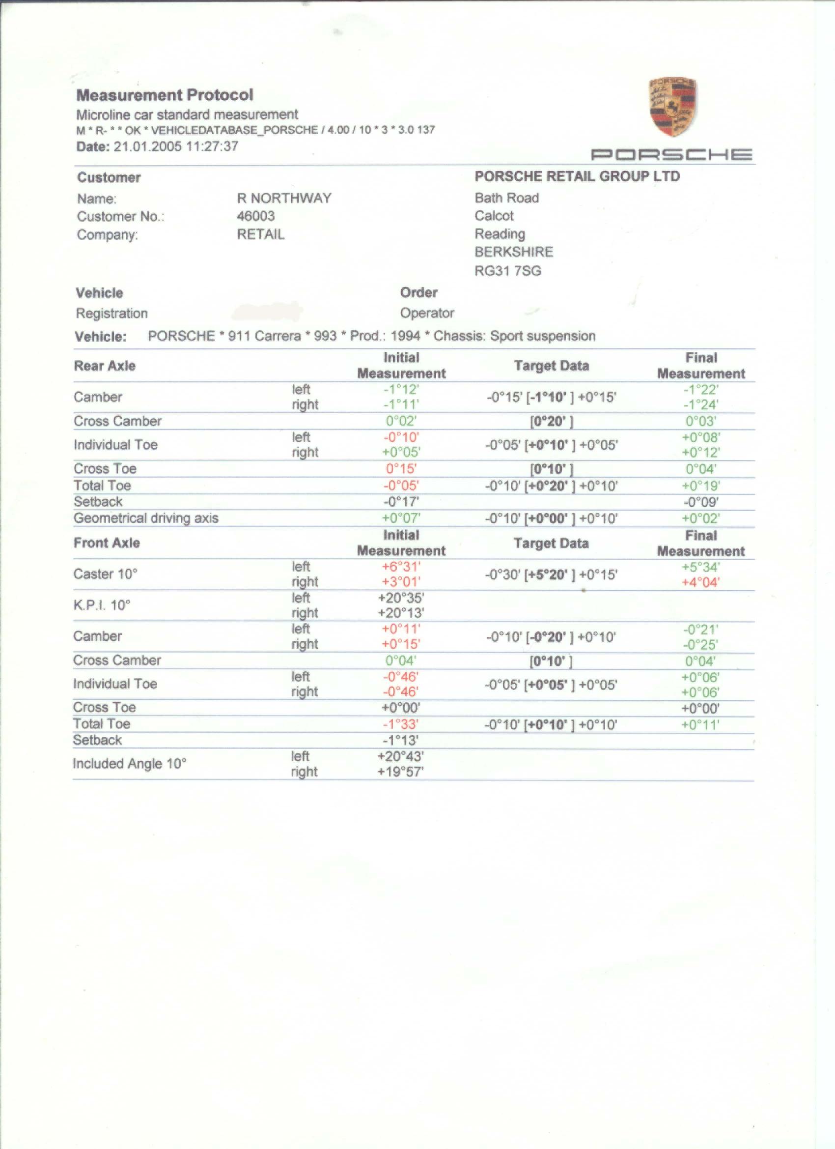

I had the Bilstein HDs fitted to my car last week, The work was done by Porsche Northway and OPC Reading for the Corner Balance and alignment.

billies fitted and set up today at 9m
fantastic difference in ride quality - feels like a new car - really controlled over roughter stuff and doesnt shake your fillings out.
Sits alittle lower than it did and running their own fast road alignment settings
car has 50k on the clock - and old shocks were well past the sell by date!
yep thats me!
P*0 RKA pig really :)
settings - eventually just asked them to set it up with what they recommended for fast road - seems to work - dont know where i put the damn print out sheet :-(
looks like slightly increased -ve camber on rear and if anything less -ve camber on front than it did have? - definately feels much better on the new shocks
