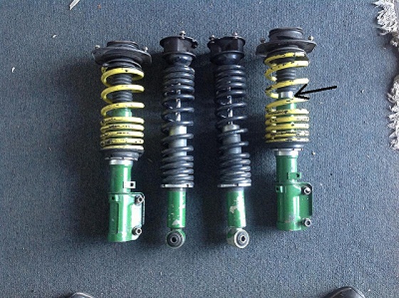

Ok lets clear this up so there is no confusion. This is a 964 cup shock and is what Melv should have (no idea what you actually have fitted) forget the top mounts in the pic but do take a close look at the damper piston and it's size. Yes these are green colour shocks too. They are single tube design and can be rebuilt.
