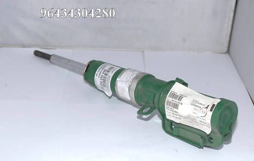

Now compare the above with a 964 RS shock. You will notice the piston is much smaller in diameter and also note the end cap design. Notice the way the shock body dimples inwards, i would guess it would be impossible to remove the piston from the body due to the deformation of the shock body hence the reason they cant rebuild them!! The cup single tube design is stronger by virtue of the bigger diameter piston and therefore more suitable for racing ! The struct insert can be removed completely from the body of the shock making them easily rebuildable. Both Front designs are green coloured !!!
