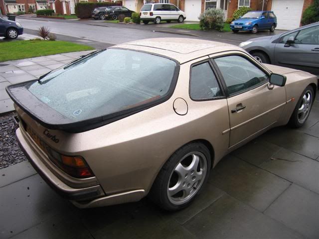

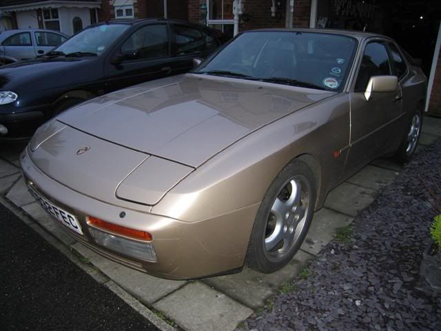

However things got better the more I looked. The paintwork has to be seen to be believed. Not a spec of rust. Usualy the more you look at a vehicle the more blemishes you find, but I'm really struggling with this one. The front end was given a respray a few years back for cosmetic reasons, and 3M film applied. There ar 1 or 2 minor chips here and there but nothing to worry about.
I'm starting to go on a bit so here is a quick pic for now. poor quality as its getting dark and the sd cards full! More tomorrow if thats ok?

edit- I'm obviously not so good at posting pictures!
Thanks. Its an 86 turbo model, with 113,000 on the clock, though you wouldn't think so. The last owner had it for 14 years.

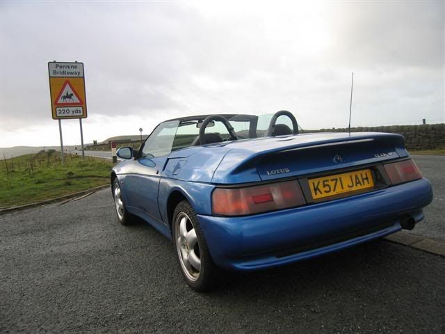

How do you find it compares to the lotus? I remember when I first got mine (an '86 Turbo, that is) and took it up to Dartmoor, just as I was coming up to the fun bits this white lotus like yours appeared in my mirror. He was really provoking me so when we got to a straight I just opened her up and watched the little white spec disappear :D However, I had only had the car a few days and was not very confident in the corners, so that white spec got much bigger each time I got to one, and then would rapidly vanish again coming out the other side.

The Elan and the 944 are different cars entirely. Fwd v rwd for starters.
My Elan has many upgrades and puts out about 210 bhp with a similar weight to the 44, suprisingly seeing as its fibreglass.
It is very difficult to get traction being fwd, even with and aftermarket lsd (Quaife) fitted. 0-60 should be less than 6 seconds, quicker still if I could get traction!
I've obviously not had chance to put the 44 to its limits, having only owned it for around 30 hours. I bought it as a daily driver, wanting to keep the Lotus for best. However its so bloomin good, if I had a double garage I would put them both away and keep the Discovery. Not sure the wife would appreceiate that!
