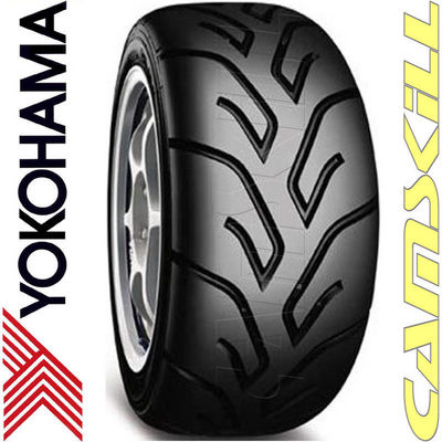

Track Spec tyres are what's known as R rated, ie they are road legal but are desiged for track use so have a compound that can cope with getting really hot, get stickier as they warm up and have minimal tread for dispersing water.
Common brands are:
Toyo R888
Michelin Pilot Sport Cups
Kumho V70A
Dunlop DZ02G
Yokahoma A048-R
