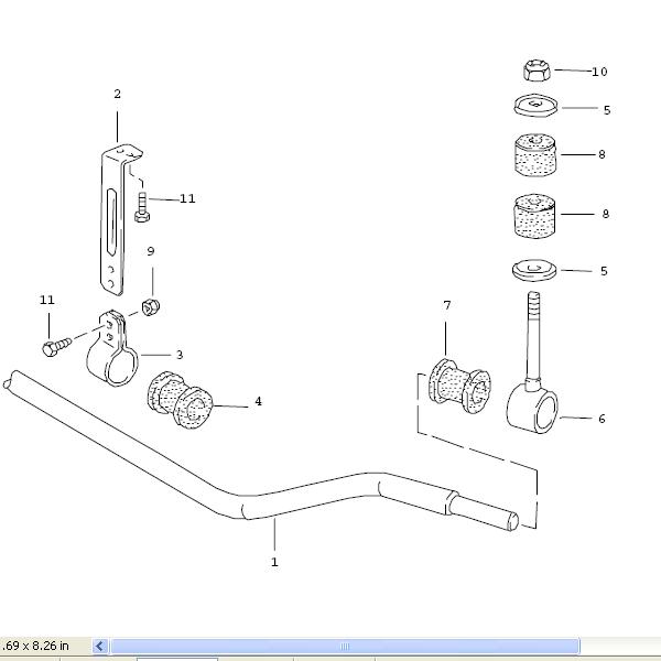

The antiroll bar should sit very snugly in its bushes. If you can see any sort of gap then it really is best to replace them. Mine started clunking from the left when going round right hand corners and when I jacked it up you could almost see daylight between the bush and the bar. The new bush was just a few pounds and was a tight fit to squeeze over the bar but got there in the end. I was a bit of a tightwad and only replace that one bush but plan to replace the others soon. It's easily done but jack up both sides of the car to totally unload the bar itself.
that's great thanks diver944, did you opt for the standard bushes or did you go down the polyurethene road?. Just to clarify i've understood you, no need to remove anti roll bar, because the bush is split, it fit's around the bar?, 1hr-2 hr job?
I just went for standard and I only replaced one of the four buses - the inner N/S bush that mounts the ARB to the underside of the car. I simply removed the outer droplink bush that holds the bar to the wishbone and then slid the inner bush along the bar before refitting th eoriginal outer droplink again. From memory it was a couple of hours all told.
If replacing all four I think it would be simpler to remove the whole bar, but don't hold me to this as I haven't done it [:)]
I've only replaced #4 in this diagram:
