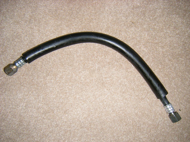

this is the offending hose in the engine bay from the left hand side up the fuel rail, anyone know where i can get one or its part number so i can order one from gsf?

arghhh!! cannot seem to fix this at all. right new battery, new plugs, new dme relay (just changed this for the hell of it so i had a spare) new hose from pump to pressure dampener on the rail as old one was leaking really bad and still not sorted if anything its getting worse cant start it at all now before it used to take 30-40 mins to get it started. am definately getting fuel pressure have had the hoses of while craking and fuel comes out at a helathy pressure. im not sure if it could be electrical, dizzy or coil. any ideas? am just sick of buying and changing things for them to not fix it
