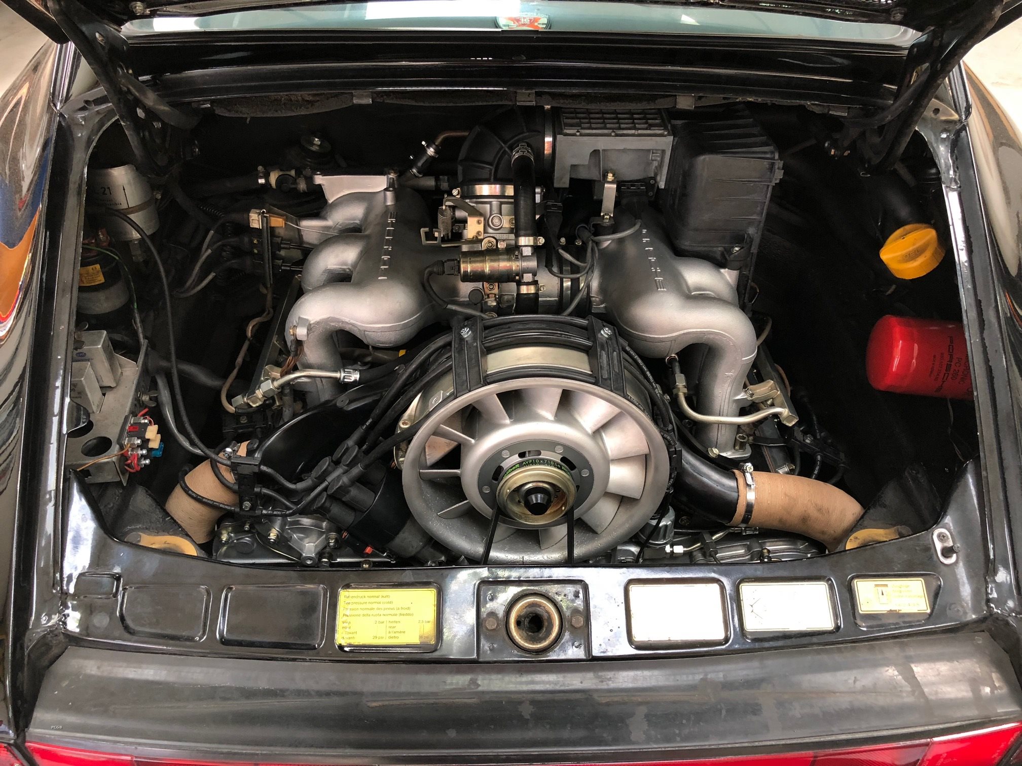

Carrera 3.2 to 3.4 engine rebuild
Beaky
Full details to follow, engine now back in the car awaiting the first run.
Items done prior to the engine rebuild:

Tell us how it now drives in comparison and expected BHP ... extensive modification to a 3,2 ...... This is one of the unusual engine mods .... Good One ??
I'm still awaiting the call to go pick her up, then she needs around 1k miles to fully run her in, once completed then new oil, recheck and tighten everything and off to the Dyno to fine tune.
So it'll be a good few weeks before I can report back but in the interim build spec was:
New 3.4 Cylinders and Pistons
Fully honed and gas flowed heads
Shrick base/spring/retainer set up
Docherty 993SS cams
Porsche Racing Bolts
Lightweight rods
67mm throttle body
Full SSI exhaust with two in two out back box
And lots of new shiny bits.........
Beaky said:
Docherty 993SS cams
Lightweight rods
67mm throttle body
Fantastic but you could have cleaned the muck off from around the engine cover lock[:-]:ROFLMAO:
