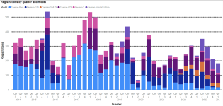

in case useful, here is the UK registration data for Caymans....

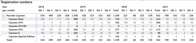

And in tabular format for 2019-2020
