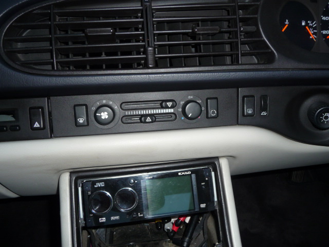

Back to the air-con. My 'panel' seems to be different to that shown in my 'Handbook'. Which is the air-con button? See pic...
Oh! I understood that the red/blue graduated controll was 'normal' heating / ventilation, and the 'numbered' was air-con. That explains why it doesn't feel like a fridge then.
It's a common misconception but on air-con cars there are two half-buttons, one with a snowflake on it. In spite of the slightly "functional" execution it wasn't an afterthought as the first oval dash cars were Turbos with air-con.
Like this one. Two half buttons on the left, the one on the right turns the A/C on
