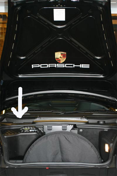

Right - I've braved the arctic weather! Here are two pictures - the first shows the location generally and the other a close up of the window - you need to look 'through' the window to the chassis number stamped on the leading edge of the scuttle panel - as below:
HTH
Philip
It's worth mentioning that I have seen two cars where this chassis / VIN plate had been modified (stolen / ringed) - so IF you're after the ultimate in protection as you go across European borders, take the cars to an OPC and request they plug the car into the PST II - this will ALSO show you the chassis number the DME has burnt into it. Get a print out from the parts department of the OPC which will show the car as ordered and specified on the Porsche computer and then you've done all the cross checking you can.
Philip
Thank you very much philip for your pics and tips!![;)]
The fotos are from a 986 and i guess cayman should have it at the same place!![:-]

The 996 and 986 have the same front ends, so the chassis plate is in the same place - sorry no desire to own a 997 so can't comment.
The car in the photo is my Guards Red 996 GT3. The colour is aweful as I've had to keep the cars inside due to the lousy weather we have up here [:mad:]

I think the orange one is a GT3.
(ooops - took me too long to type - Phil beat me to it [:D])
In answer to your earlier question - yes I have a Boxster [:D]
Boxster 986, 996, GT3 etc all have the window in the same place.
I'm not sure about Boxster 987, 997, 997 GT3, Cayman - someone should be along shortly to confirm [8D]
If one of these has it then all the rest will - they are all the same forward of the windscreen.
I suspect it's the same as the 986/996 series cars.
