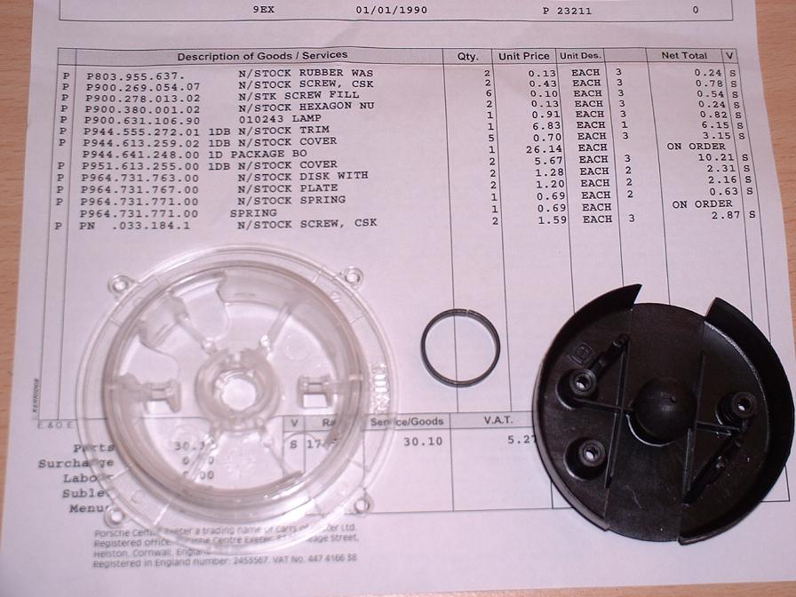

This is the kit required to take a perfectly good electric mirror and make it manual (the 964 parts on the bill):

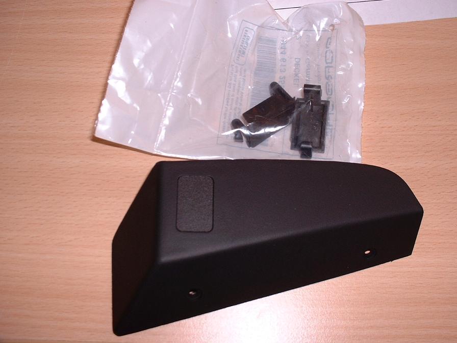

and this it the stuff you need to make the electric mirror and window switches disappear:
Now that is awesome! I have been looking for those two trim pieces for ever. So you have a part# for each side? I assume your local OPC ordered them?
Jeremy
Which pieces? If you want the switch panel itself then you need the passenger side one from a RHD car (mine is just a LHD passenger one) which is 945.555.271.01.
If you mean the actual blanks for the switches then they are 951.613.255.00 and they cost an eye-watering £5.67 each!
It saves grammes, if not tens of grammes[:D]
I actually prefer wind-up windows - something I confirmed to myself when I ran my GTI for 6 months, and I can live without power, heated mirrors. Actually the 968 mirror conversion is something like £70 cheaper using manual adjusters and unheated glass, should anyone else agree and fancy them. I'm just going with manual 'elephant ears' for now though.

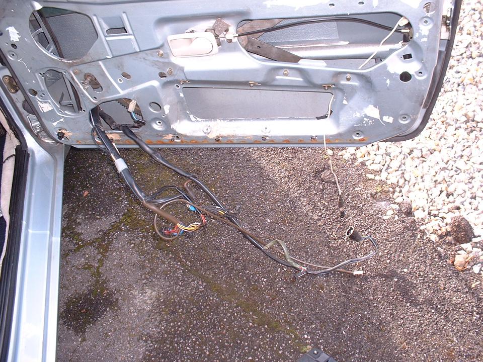

I can also recommend stripping wiring looms as a fun pursuit - loads of fun when you want to keep 2 wires from a pack of 25 or so, so you can't just chop it all off. I was astounded by the wiring loom for the driver's door - so much so I took a picture which I can post later if anyone cares to see it. I have stripped and chased it back into the kick panel behind the tailgate release and I will continue from there back to the console and across the car to the other door.
Anyhow I now have a drivers door completely devoid of rubbish (OK I kept the HiFi speaker pack) - no electric window, no central locking, no flashing lock button, no electric mirror, no switches. I took the time to make up a new waterproof membrane as well, which was fun in today's wind.

Here's a pic of the loom for the driver's door:
Hi Fen,
Was there a plastic membrane between your door and the door card? If so, did you put it back? And if so, what did you use to stick it on with?
Cheers,
Jim.
