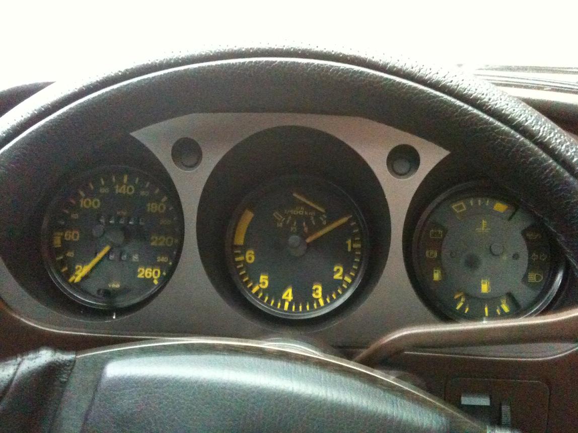

With the interior I have found that when driving my had was covering majority of the tacho so I have done some rearranging of the instrument cluster. I have moved the tacho to the middle, the speedo to the left side (as not enough length in the speedo cable for the right) and temp and fuel gauge has moved to the right. Nice clear view of the tacho now.
