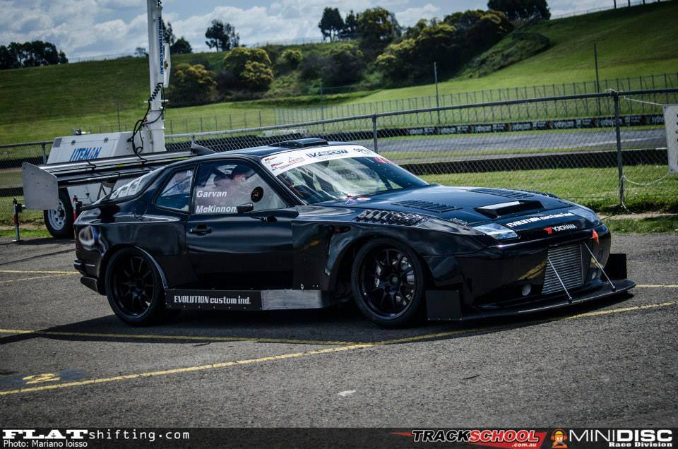

This season I ran my car in a dual driver capacity. That is I drove but so did my builder Paul McKinnon. Paul is a great driver and has tasted success on the track many times previously. We entered 5 Sprint events this season and Paul won every one (breaking all of the track records) and we now have the fastest Porsche that has ever been in the club (which has been running for many decades). To note, we have been up against many GT3's, Cup Cars, 962 copy and even a highly modified 996 RSR with 4Ltr engine, Motorsport ABS, full Sequential tranmission (now with pnumatic paddles) and of course they're all on slicks while we're on Yokohama AO50 R specs.
We had our last round for the season on Saturday. Bright and sunny at Sydney Motorsport Park Grand Prix layout. (Same layout as we'll be on for World Time Attack Challenge in 3 weeks.) We had some new front Aero that we were very keen to try and expected big things from. We still ran on old tyres, one set from October last year and we also ran into a boost leak which kept power down quite a bit. Alarmingly I also came into the pits to find that the rear left tyre was only showing 11psi hot!! Confirming the squidgy rear I was feeling! So we swapped to the year old tyres and Paul went out and beat the benchmark time of 1:38.8 by doing a 1:32.2 which opened a few eyes up! The RSR managed a 1:35.6 and the fastest BMW was a road going E30 M3 that did a 1:40.3 Wolf in sheeps clothing with a Sequential gearbox in that road registered car. Sounded great. Was very surprised that some of the BMW full racecars didn't do better. Not sure what was wrong there but they had several fully caged cars turn up on trailers that promised much. I think their previous best car has done a 1:35 or .36 from memory.

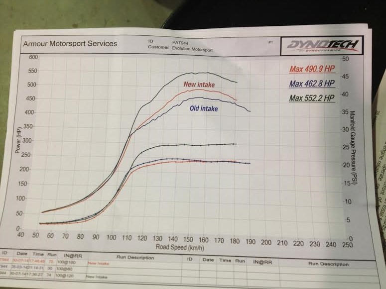

The latest few things we've done to it is make a new custom intake to replace the stock one. That helped on the dyno quite significantly in terms of power gained. Also we were going through headgaskets virtually every time we went to the track. So we've O Ring'd the block, or actually sleeves, and had some brass rings made up to go with a copper head gasket. So far so good! I guess while I'm here I may as well say that we moved the power steering pump inside the car and also built a very custom front sway bar to relocated behind the front axle. We also removed the large (and very efficient) air to oil cooler and changed it to a smaller water to oil heat exchanger. These three changes were so we could make room to build a proper diffuser in the front splitter. After driving the car last weekend I can say that it was all worth it judging by the feeling of stability it creates now. Oh and we also replaced the front brakes to a set of Alcon 6 piston monoblock over some 375mm Coleman Racing vented floating rotors and hats. Very solid underfoot now. (Compared to previous Big Reds)

The inlet manifold was just made in the shop and no huge amount of science went into it. Just common sense and space. By just changing the intake we made definite gains as you can see. At 20psi it's about 30whp and at 25psi it's about 50whp on same dyno under similar conditions. We also tuned it so there is now throttle based boost ramp. More progressive or forgiving to drive. We might just tune it for WTAC to allow circa 28psi on the straights if we're ahead of previous best times. Could be the difference between 1st and 2nd place if I'm not being too presumptious. [8D]

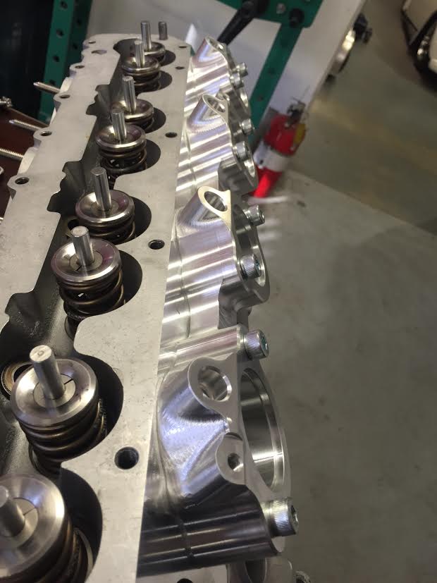

So then I had to decide what to do with the car. After a serious re-think I started to consider finishing the 16v motor and had some fairly deep discussions about what our target was for the new motor. It became fairly ambitious (850bhp @ 9000max) and is now back on hold. In the meantime the builder/supplier had a few spare parts that he was willing to supply to get us up and running sooner rather than later with an interim motor. So we are just finishing up on this unique little 2.5ltr 8v motor. The pistons are custom 102mm CP with a smaller wrist pin located higher in the piston. They're quite light and have been made to go with the custom longer Carillo rods. The idea is that we wanted to reduce the wider ellipse via the stock piston / rod design. Less wear and much kinder in terms of Harmonics. The static compression ratio is just over 9:1 which is higher than I've seen on an 8v motor. The head has massive ports (way bigger than I've seen anywhere else) and a very high lift cam (.595 in / .526 ex) with solid lifters. The target on this motor is at least 600bhp / 8000rpm max. It has the deckplate, large 9/16" Arp headstuds, doweled girdle to enhance the structural rigidity. We're also running a much less lightened crankshaft and a dampener on the nose to assist with harmonics. We're just finishing off the assembly of this and back into the car. Then we'll make up another intake to suit. Pic showing new flange. Note the side of the head has been decked to make it totally flat. The ports are so big that there was very little material to make a seal.
Should be on the dyno within 2 weeks. Really looking forward to seeing what this little motor produces. It will be very different from the previous 3.1 8v for sure!
