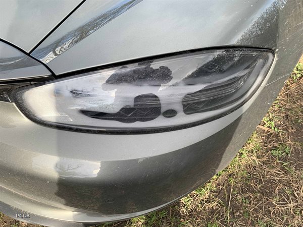

I follow Neel Jani on instagram and he posted a story of his 992 911 GT3 and it also had the same issue (image attached). It's hard to tell in the image but the whole lower part of the light is filled with condensation.
