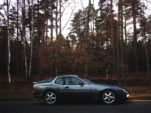

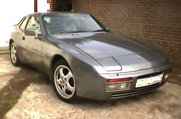

They'd be fine. They are from a 993 (I guess), but they are exactly the same size as my 964 sourced Cup 1's.[FONT=verdana,geneva"] [FONT=verdana,geneva"]The 968 used 7.5" fronts, but the offset was slightly different and actually placed all the extra width plus another 3mm further inside. In other words the 7.5" 968 ones would sit 3mm further under the arch, so although wider they look narrower if anything. Of course that could effect the handling and while I have not tried a car with 7/5" fronts in the 968 offset I can confirm the ones I have and in this auction don't cause any nasties.[FONT=verdana,geneva"] [FONT=verdana,geneva"]Of course Cup 1's look much better than Cup2's in 17" [8D][FONT=verdana,geneva"] [FONT=verdana,geneva"] [FONT=verdana,geneva"]Factory rears are all the same width and offset for narrow body 911/968 by the way.[FONT=verdana,geneva"]

They are a bit lighter than replicas, but I also have 18" Cup 2 reps (chosen as in 18" I thnk the Cup 2 is nicer) which are heavy, but they don't make a huge difference.[FONT=verdana,geneva"] [FONT=verdana,geneva"]I could do you a deal on an Autothority MAF and chips to suit it running 1bar... [;)][FONT=verdana,geneva"]
I have Cup2's (7"&9" x 17")on my S2 road car, they look better than the Cup1's I feel. Although Fen's colour combination and low ride height looks stunning.
If you change from 7" & 8" D90's then the car will understeer more, if you are removing 7.5" & 9" D90's then the handling changes will be marginal, although the ride is firmer.
7.5" 968 fronts will help reduce this effect somewhat.
As a matter of interest, my prefered combination from a handling perspective is 8" & 9"x 16".
Also, most Class2 Club Championship 944S2 Racecars run 8"x16" alround with 245 section Michelin Cups (largely because rim width is restricted to 8").
