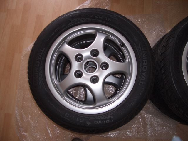

I don't think they are cup 2s as I know what they look like, but I'll post a pic later and we can see.

are they Cup2s? I thought the 16" Cup1 was the thin spoke varient (?) [&:]

Photo as promised.
Fronts 6J16 ET52 944.362.112.00 with Uniroyal 205/55 ZR16
Rears 8J16 ET52 944.364.116.00 with Uniroyal 225/50 ZR16
