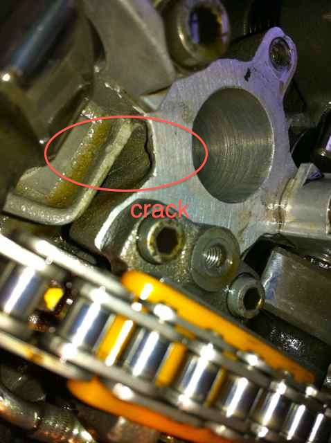

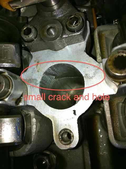

Ok to the main problem is I was changing ingnition leads and have noticed that one of the spark plug holes was full of oil, so I manged to clean it all out and have noticed a crack and a small hole 1/4 way down the spark plug hole. So it looks like I need a recondition 16V cylinder head for a 2.5 944s, but cant seem to find where I can get one, does anyone have some advice.

Its not unusual for the cam cover seals to leak into the spark plug tubes. However since you mentioned a hole & a tappety sound i'd suggest removing the cam cover before going any further. I'd be concerned about where that hole came from.
I have uploaded a picture if you view it larger then on the left about 10 o'clock you will see the crack and hole i am talking about. will i need to drain the oil before i remove the cam cover? if not I will do this in the morning and matbe can provide more information.
I am not sure, it is a 16V motor and it looks like a normal cam cover, not sure what a cam box is
Ahh.. Your timing chain tensioner mounts on that plug hole... I think your tensioner guides have broken and have caught under the chain causing excessive tension for the tensioner.. It is held on by 2x 6mm bolts just next to plug hole No2.. looks like it has ripped off the head.. ...(only seen this happen once)
Have a look at this.. sort of explains what i'm saying

umm when the timing belts and balance belts and water pump where replaced would they off had to work on this as well? does it mean a replacement cylinder head or can this be fixed. I will take cam cover off tomorrow and take some more photos to post. My car still runs ok so hope it is not that drastic
You don't need to drain the oil. Seeing that pic I wouls agree with red leader but you won't know for sure until you get a look inside. More pics please!
That's the only reason I can see for a hole in the head on No2 plug hole.. Hope I'm wrong.. Don't use it until you've taken the cam cover off..
ok thanks will take it off tomorrow and post photos for your expert opinion, thanks so much to all that have replied, looks like it was previously repaired

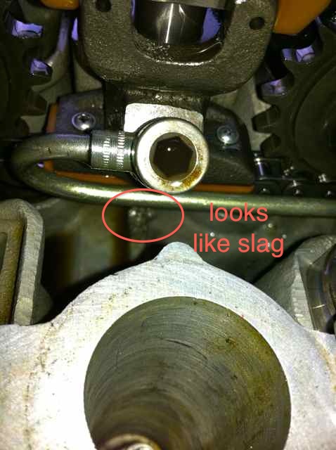

Without seeing it myself its hard to tell but it looks like the previous repair is still ok - has it only been partially welded or is there evidence that the previous weld has failed? Of course, a replacement head is the 'best' option but a very expensive one. Is it possible the repair is holding up & it has always leaked some oil since the work was done?
