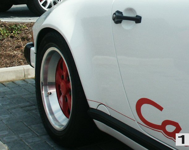

![Ig121702557.jpg](https://www.porscheclubgb.com/forum/legacymedia/upfiles/544/Ig121702557.jpg)
plhorner
Moderator
I take it that you're now running 7's and 8's from what you've said on the thread and the look of your avtar (which incidentially I've admired for a long time). Did you just swap your 7's over and move them to the front ? I once saw a car that a friend of mine did this too and for some reason that I couldn't put my finger on it just didn't look right. I always assumed that there were 7's available with different offsets...... But it sounds like I'm wrong.
ClubSport 911
As delivered, the CS came in MY 1988 (*J production) - with 6" fronts and 7" rears. I understand that this configuration is standard. However, for MY89 (*K), then I think Porsche moved to 6" Fr and 8" rears. In speaking with a bunch of CS owners, and other folks, it is often mentioned that the steering of the 911 3.2 can be somewhat light...
Therefore to offer a little more feedback, I opted to shift 7's to the FR and dispose of my 6's. Also, the front of the CS is even lighter... Collapsible tubes instead of shocks, no underseal, no fog lights, no headlight washers, and a different front bumper. Even now, at speed, I can feel the front getting lighter.
Francis Tuthill remarked that If I thought the CS was light @ the front, I should try some of the earlier marks with 5.5's !
I bought new 8's for the back and had them re-furbed from Pristine Wheels at £75 a pop, all in.
