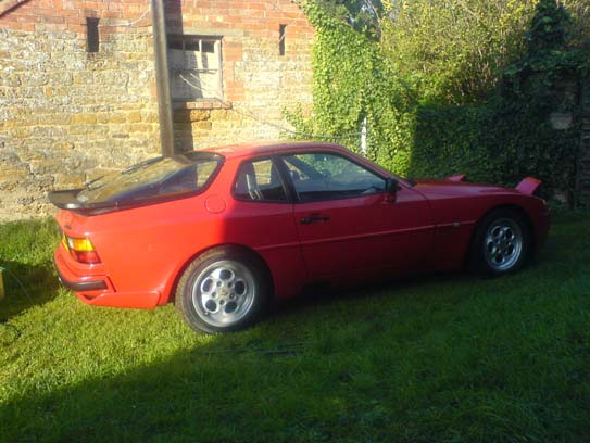

Definitely keep the car. I did exactly as you did bought the early car and then learnt the advantages of the later model! I ended up not changing the early brakes for M030 setup because everyone kept making long expensive lists of the parts I might need for the conversion. Fortunately I have just bought another 86' turbo which has already been upgraded with M030 brakes and LSD gearbox.
Looking a bit further into it (and asking Jon Mitchell) how it can still have the early offset wheels on it, it seems (and looks) like all the chap has done is buy two hubs with calipers etc from a later M030 car, bolted them on and not changed anything else. Looks fairly simple to me and the car drives, corners and brakes beautifully.
The only thing I will say is that I've really noticed the difference between the non LSD original and the new LSD equipped car and I've not yet been out on the track. In the wet the car has infinitely more grip pulling off where my old car used to struggle accelerating in 1st, 2nd and 3rd in the wet (especially when overtaking) and when accelerating out of roundabouts and sharp bends. The old car used to slide and fishtail violently feeling quite unstable at times where as this car feels very much more balanced and controllable on the limit. It doesn't have such a bite back as the rear end comes back in line. Everything feels tight, responsive and under control. I feel it's a very worth while purchase and only 6or so hours of labour to change a gearbox.

p.s. I have attached a pic I have of the hub with brakes attached incase anyone can gain anything from it by looking, cant see how myself but it can't hurt. (also the car has no ABS obviously "" which I prefer)

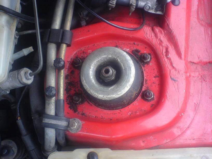

I will have a look at the back of the wheels as soon as its dry, its hard to establish exact age because its an import. Could be a late 86' but was pre ABS. Jon informs me that the front hubs had the same offset and that it was the wishbones that changed the offset on thew later cars (or something to that effect) to I assumed the wishbones etc were left original. I'm farely sure that the suspension is not M030 but wouldn't know the difference between early and late suspension. I have taken a pic of the top of the strut if this helps...
