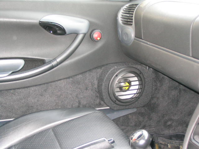

Attached a picture of what the set up looks like.
I am willing to part with the door cards for £310 a pair (exchange & excl speakers). Fitting will be approx £30 per side and this will include wiring within the door.
Points to note are that these are not just door cards with speaker pods attached. These are fully sealed and ported door enclosures designed to take high power levels and deliver the very high quality sound.
  • Each Speaker Pod is rigidly constructed, reinforced internally and carpeted in Black. (see Pic)
  • Behind the door card is a further cavity that is fully encased and ported (polycarbonate/fibre glass) and fixed to a rigid panel reinforcing the door card.
  • Each door card is sound damped with Dynamat ( £30sq ft!) and each speaker enclosure filled with sound dampening material.

The fully sealed enclosure allows for deeper and cleaner bass response. It avoids vibration in the door, the ingress of water to the rear of the speakers, and the damage of the door membrane . That's why Porsche fit their door speakers with a dedicated enclosure (usually the Nokia Speakers system). Unlike Porsche though these Speaker Pods are designed for speakers up to 6.5 inches and a mounting depth of almost 3 inches (because of the rear cavity). This means more speaker options in the 6.5 inch range and with a 3 inch depth you can install mini subwoofers at a later date. The rigid construction and dampening means power levels of 150 watts per speaker can be handled without internal vibrations and rattles to spoil the sound. You can upgrade the power or speaker without worrying whether the enclosure will be damaged or sound quality detriment. The separate tweeter is placed at ideal level for imaging. This is very important as the treble is lost if placed at the floor level, but if placed in the dash it will sound disjointed from the bass & midrange from the door speakers. That's why Porsche do this in their Bose equipped Cayenne.
