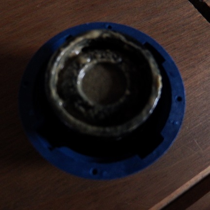

Found much more emulsifying in the water yesterday actually partly covered the cap - still small amounts in Oil Intake

There is MAYO in Coolant - see attached photo
Not sure if its water

The old cap I have now replaced was leaking it did not go on tight he THINKS that it could be that or a loose connection apparently mayo in Coolant could be because of bad Cap or maybe bad joint

Its a small amount of Oil in the water which SHOULD! do o harm as lons I I don't use the car
Have cleaned up the oil in the Coolant Tank has not marked it yet - Which I have been warned about

The ingress into the water is almost like a silicone feel very smooth
It seems to be the case with these cars that as soon as you say anything about oil and water everyone tells you its a knackered engine. I would trust what Hartec tell you'll probably find it's just a seal in the gearbow cooling set up.
The coolant should feel 'smooth' anyway. The inhibitors make it feel slightly like baby oil.
