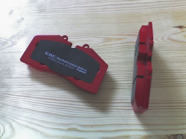

Got my Red Stuff pads last night (still awaiting my disks) but interestingly enough the fitting instructions that came with the pads specifically said NOT to re-fit the original anti-squeal shims or the thickness of the pad would be too large.
