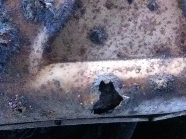

Further investigation reveals knackered heat exchangers..........I should see this as an opportunity to replace everything!

Afraid so, there's a hole in it and its blowing! Been advised its an MOT failure.

It's a 94 so think it will be a Bischoff type, will jack up and check later to busy at the moment manning the bilge pumps from this mystery leak! Thinking or renaming the car Titanic!
Interesting, I was told a rotton heat exchanger is not an MOT failure because what your looking at is the outer skin NOT the actual heat exchanger which is within.
My offside one had a hole near the front edge, rusty as heck. Wire brushed it back (which made the hole bigger) brushed on rust killer, and carefully covered the hole with liquid metal, rubbed it back before it set, and its absolutly fine.
3000 miles later and you can't see the repair. I've been informed that its not that unusual on the 993 as when something underneath is adjusted and its tight for access (can't remember what) usually the mecanic knocks the heat exchanger and starts the corrosion off.

It's done 102,000 miles. I think the problem with the exchangers is the car has sat for a couple years and done very little, as in no mileage! Moisture in the exchangers as PO used to start the car up and let it run for a couple of minutes! The results are attached.

It's a 94 model and has Bischoff exchangers which are proving difficult to source new. Thinking of changing to Gilette exchangers, CAT delete and mufflers to suit, probably Dansk. Early Christmas present...........
