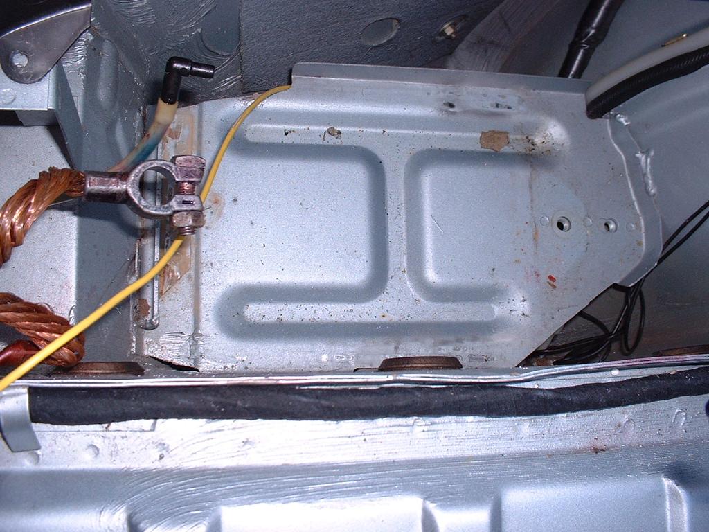

Jeremy,
Good and bad news. The clamp p/n is 945.611.209.00 - doubtless the allen screw is another part.
The base is welded in and would be unlikely to fit the other well. On the positive side it welds to the insides, so you would not have any visible paint to repair - just a quick brush over under the wheelarch and by the fuel tank to prevent corrosion.
It might be part of the shell though, so you may need to get one cut out of a RHD car.
Rear of the car is at the left of the pictures BTW.
I have 3 more pics if you want them - let me know and I'll email them to you.

No probs. I have 3 more pics - very similar but showing each of the 3 welded edges. Let me know if you want me to send them to you.
