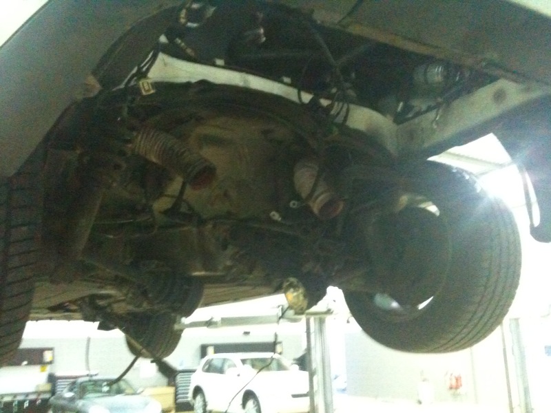

Few days ago i took my car to OPC Leicester with a 4wd light/abs light fault and whilst it was in we were talking about a couple of oil leaks on the engine,one had got to the point where something needed to be done.....
After some investigation the leak was traced to where the barrel (x6) bolts onto the main part of the engine,one was quite bad,a little head scratching later and some getting used to the idea that a fair sized bill was coming my way i agreed for the engine to come out.. OPCs get a lot of stick on forums but all i will say is that these guys have the feel of specialists and they were genuinely sympathetic to my position and a very fair time estimate was done,and because its an older car they are doing it at a favourable labour rate....The guy that is doing the strip is very methodical,and didn't mind me watch him strip the engine down for 10 mins this afternoon.The engine is still quite low milage wise so in order to keep costs as low as possible its basicaly having a re-seal of bits that need it.The main culprits are the six round gaskets that attach to the main case,they were brittle and in some cases broken.My expectations are realistic and i realise it will probably need a full strip and rebuild later on in its life but it gets used fairly lightly so i am hoping this will keep it rolling for a little while yet,with less oil needing to be washed off my undertray at service time....
