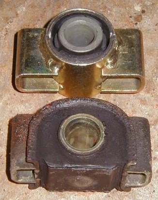

.....and here is a picture of mine [:D]
Above is the new 968 mount with lots of metal and less rubber, below is the original S2 mount. It really helped reduce the tramlining on my car when I fitted 17" wheels. Around £40 each from the OPC

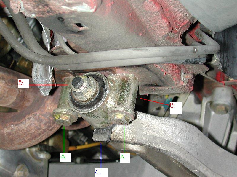

Look at this pic below. The mount is held to the underside of the car by two bolts A. The castor adjuster bolt is secured by two bolts B, the rear is visible here the front is hidden. The castor adjuster is the black tab C.
Loosen and remove the rear castor bolt B whilst ensuring the adjuster tab C does not move with an open ended spanner. Remove the two securing bolts A. The old mount should now slide backwards off the castor bolt without the bolt ever moving.
Slide the new mount onto the castor bolt and tighten everything up
If the black tab does move you will need a realignment [:)]

I think I am starting to understand, Is the tab (c) part of an eccentric bush that fits inside the arm, if so could I mark its position and just put it back if it moves?

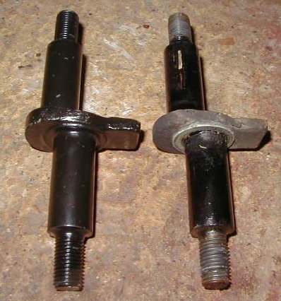

These are my eccentric castor bolts though [:D] Berg does this picture make it easier to see how it all works? Marking the position would get you close, but it's only tiny movements that put the castor right out. If you leave the front bolt tightened then it cannot move (thats my theory anyway)
One more thing. These castor mounts are only for S2's and Turbos. It's not the same for the earlier cars and there is no uprated mount available for 17" wheels - sorry [:(]

My advice is don't buy a new eccentric bolt. It's identical to the one already on your car. They fleeced me for two when I did my upgrade and as you can see from the photo above it's teh same one that I already had (only cleaner). By all means get new nuts though [:D]
