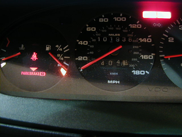

Who will be the first anorak to post a picture of their Orange light for Slim?
Well it looks like it's going to be me [8|] Half way to work this morning and the light came on, just short of a motorway service station. So I pulled in and took the pic (camera was armed and primed just for this purpose [8|]).
It was pretty dark so had to use the flash, I'll see what it looks like when I get home and upload from the camera.
My light comes on just as the needle has gone through the red zone and has appeared the other side [:eek:] but I know from previous experience that I have two more gallons in there - one day that bulb will fail [&:]
Voila
Cheers, my needle was at the other side of the light, but not on... Mind i only got 65l into the tank! Will pop a 5l can in the boot as it gets closer and see if i can get that light on. Wonder if i can reset the needle!!
Actually you can. I have not done this but those white dial kits that you can buy often come with a small tweezer type tool to remove the needles. If you do find that yours is on wonky then you can reposition it (or your bulb has blown so keep that 5L can handy) [:eek:]
