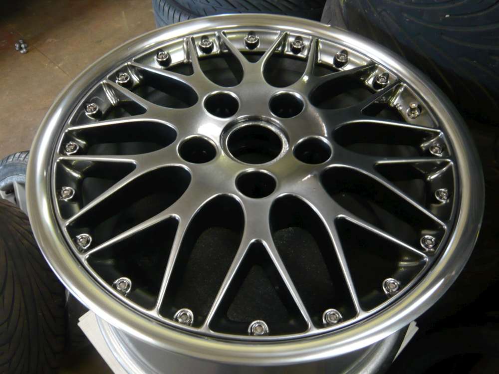

I have the wheels below fitted to my 986, I believe from the factory:
They've become awful scabby, with lacquer peeling off the polished rim and paint beginning to bubble on the painted centre. Therefore, I'm looking to get them refurbished.
Now, this seems to be a pain for a number of reasons - I've tried local refurbishers and the company that did my 944 wheels, and most companies won't touch them because: a) they're split rims, and b) the outer rim is polished, and the inner is painted, and they can't handle the polishing of the rim. Since I'm looking to get them back to as close to original as possible, this is a no-no for me.

I had my split rim wheels refurbished last year and like your own they had a polished rim, I chose to have my rims chrome powder coated as this is as good as maintenance free. If you get them polished you'll have to polish them on a daily basis to keep them looking good. You could get them laquered once polished however the slightest chip allows water to seep under the laquer and your looking at a full refurb again.
Oh I forgot to mention Five Powder Coating can provide a chrome look finish. I chose to split my own wheels and rebuild them once all the coatings were done. I believe they could do the full refurb for you.

Another vote for chrome effect powder coat. I have done a few sets of previously polished wheels with this, and the results have been very good, a lot more durable than re-polishing them.

He has recently done 4 sets of wheels for me including my BBS LM's, split chrome powder lips and painted centers

Nice job Mikey, those BBS wheels look fab

Here's a PIC I've found of my rims finished in chrome powder coat.
[/URL][/IMG]
That's a nice looking 68 Alan. hope you'll bring it out over the summer.
I previously had the above LM's done by Mike the polisher and the results were stunning with a true mirror finish on the lips, but I hated trying to keep on top of them. Each wheel would take half an hour to properly clean, now with the chrome powder coat they take minutes like any normal wheel.
