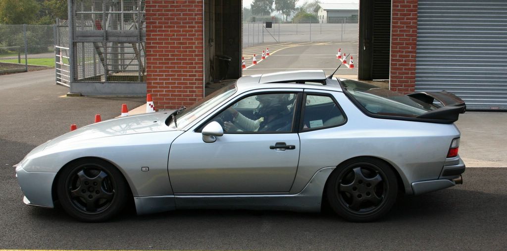

At risk of hijacking the thread here's one of my faves. I haven't got any pictures recently. In fact I think I last saw the car a few months ago. I'm toying with several options just now; I don't really want to sell it and I wouldn't really notice the money if I did, so I guess the reason it's available is because I can't really put much time into it just now nor do I reallly want to spend any more money on it at them moment, but I have to do something as I can't leave it where it is and move to NZ.

Fen - that's an interesting pic. For some reason I always thought your turbo was black, not sure why. What are the sill trims on it? And is it really as lowered as it looks, or do the trims simply hang lower down the side of the car?
Oli.
Oli,
That pic makes it look a bit lower than most and yes the skirts (which are from a 968) do hang a bit lower than the sills. It's never been black though.

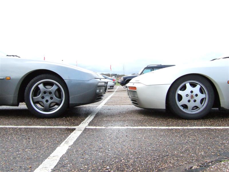

I fitted KW V3 on Fens recommendation, guess which is my car [;)] Fen`s has KW fitted also.
That pic doesn't show 17 of us Register members sitting in your car checking if the ashtray bulb is illuminated [:D]
None, loads of room. [:)]
Its also got mahoosive Weltmeister ARB`s (also as per Fens recommendation) so the body roll is minimal [8D]
