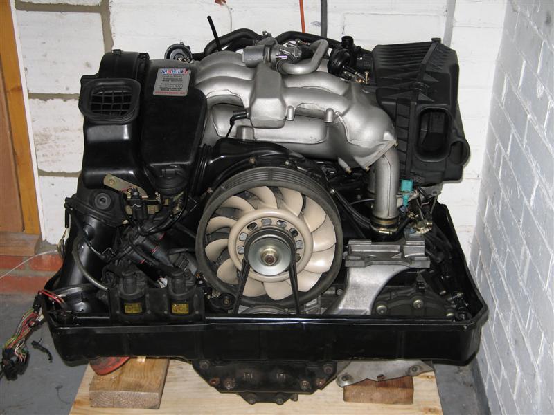

PS one other question totally off topic. Mine is a 1996N C4 (registered 29/3/06) how do i find out if it is a Varioram model ?
Karl.
Pretty easy. If when you open the engine lid you're looking at an aluminium intake manifold, you have varioram. If however the intake is black plastic, it's pre vario. I think at '96, yours will be varioram. It's useful to make sure it works however. Sit in the car, open a window and turn the ignition on. You should hear a loud "click". If not, your varioram needs a look at.
Mines definitely a varioram then - thanks for the tip.
