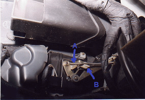

Remove glove box and check linkage (A) is in the plastic clip (B)
The clip usually breaks (cost under £2)

Tim, it 'could' be that your clip has broken so you are getting warm air all the time, but when the engine warms up it will be roasting hot, not just warm. My own black S2 blows warm air for a few minutes after its been standing in this heat, which I can only surmise is warm air from under the bonnet. After a few minutes of driving it is cool again.
It's very easy to check your clip:
1. Disconnect the battery (dont shut the boot [;)]) this stops the lamp blowing a fuse.
2. Open the glovebox and lower it past the stays so it hangs down around your knees.
3. Undo the 5 (or 6) tiny screws that hold the glovebox liner in place.
4. Slide out the liner towards you and unplug the connector for the light when you can.
The rods and clips will be on the R.H side and you can see them now the liner is out of the way. Try setting the dial to different temperatures and watch how the rod moves
My symptoms of broken clip were erratic temperature control; it would be fine then would get cold when the vehicle speed dropped and hot when accelerated or vice versa, so it could still be the clip.
I would just remove the interior light fuse rather than diconnect the battery - in fact I just do it "live" because the glove box liner has been in and out so often I know what to avoid popping the fuse.
