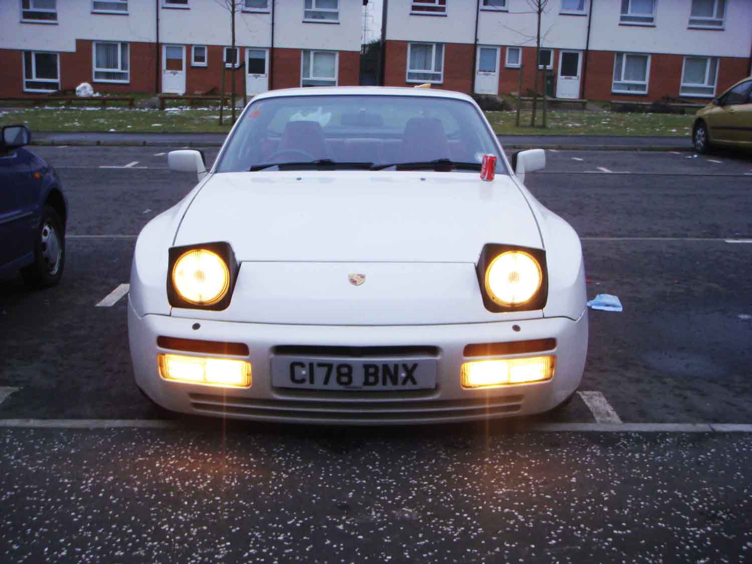

****Plus an image of my turbo[:D]

You do have a weird car though - a '96 model Turbo [&:] [:D]
Assuming your initial post should read '86 ~ are you sure it's an '86 car and not just registered in '86? Might be a different model year - one of the characters in your VIN code designates the model year - unfortunately I can't remember which one [&:]. Sounds like you have 220

sure its a 86 turbo lol n it is registered in 86

On a 'C' plate its almost certainly an '86 model year car. Its likely that ECP have sent the wrong parts.
