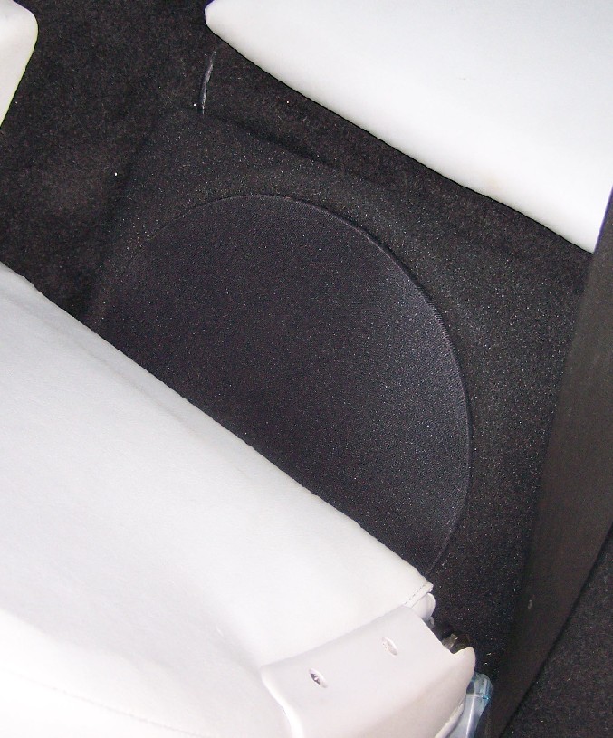

I had my amp (JL) fitted in the luggage space..its so thin it hardly impinges on the restricted space...... I also had a sub fitted behind the passenger seat (10 inch) the rear of which is moulded into the seat well.....and not visible from the exterior of the car.....the rear seat can still be used for a small child but thats it....the passenger seat rear travel is restricted by approx 2 inches...but nobody has complained yet...the bass is tremendous from this set up......in fact need to turn the sub down when carrying passenger!!!!!
If you need phots let me know....

Yes please to the photos. In my haste to get adequate sound in my car, I bought one of those all in one amp/sub things that are supposed to go under your seat. Mine didn't fit so it's now behind the drivers seat in the footwell. It's OK, and an imporvement on the "before" situation, but too inconsistent - sometimes boomy, sometimes weak, always flat, depending on the music playing. If you've got a solution, I'm interested...

Here is a phot of the sub..
It was a special order via Sextons. I had to wait approx 3 weeks...no cutting involved...the rear ofthe sub is shaped to fit in the seat well. The sub is covered in similar "carpet" material so looks like its always been there. . the sub gives an excellent response considering its restricted box siae and position.
Hope this helps
Thanks agiain - it's pretty neat isn't it, but not easy to see what's going on - I guess the sub has it's own cabinet that is sort of wedge shaped to fill the footwell in front of the rear seat? The only thing is I'm loathe to put an amp in the front boot as we really need the space for our luggage for our trips away. Would it be rude to ask what the damage was for the amp and sub to be supplied and fitted? You're only up the road from me - any chance of me taking a look some time before I commit myself? cheers
