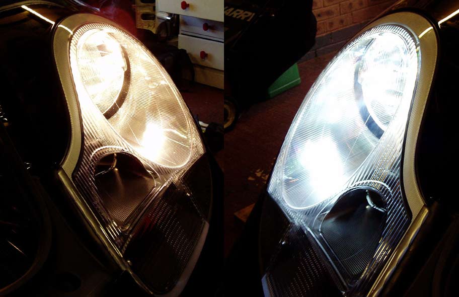

Heres a before and after pic of my Boxster (std factory Osram headlamp bulb, not Silverstar, vs 35W xenon kit)
Pics of the headlight lens lit up are generally worthless, or even deceptive. You need the pic with the lenses aiming down the roadway and see how much of that you light up.

Headlight shots are deceptive, but unless you go out in the middle of the night and use the same aperture and exposure settings on your camera for both shots, then beam pattern ones are little better.As i said the range is limited by the glass lense - the difference is the amount of light across the whole range, with much more at the extremities which is where its needed most. All i an add is that i can now drive on unlit country roads above 40mph now - with the standard lights i could see bu66er all !
