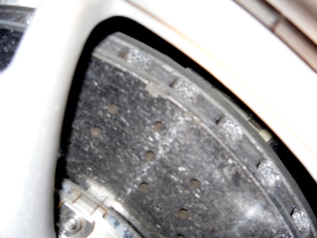

I noticed when washing the car today I've got a couple of chips out the rotor on the outside corner, just on the very edge of the surface As you seem to be knowledgeable on ceramics I wondered if you thought this is considered to be a problem? I've heard rumours that these rotor are upwards of £1500 each [&:]
Cheers, Mike
Have a close look around the disc for any other fractures. You get some hairline 'stress marks' as a normality Porsches guideline to any other cracks is that if they are longer than 10mm then I would get them inspected by a dealer.
As far as these chips are concerned it would be difficult for me to comment without seeing them.
Definatly keep an eye on them if you are concerned
Unlike steels ceramics don't crack(those 10mm crack guidlines are for steels only) as they wear the thin the coating wears off and the glossy silver/grey finish has a patchy mottled finish. Porsche have their own charts which show this wear rate in 5 degrees of severity.
Your choice is to run the disks to ruin or replace them for steels (most popular choice - hardly anyone replaces like for like).
As for noises, mine sometimes 'gurgle' sometes squeal, mostly very quiet.
The very nature of PCCB is that they are much harder than steel and do not wear. They should in theory last the lifetime of the car but it is down to the user.
The cracks I was referring to were the radial cracks from the cooling holes on the face of the disks (not the vented grooves in the centre). Those are common on steels, they should not happen at all on PCCBs.I don't mean structural cracking.
PCCBS do wear, just have a look at your own disks. They will have a minimum thickness measurement stamped on them. If they wear below that, they should be replaced.
PCCBS main failure is delamination due to excess heat soak. I've seen 6 month old 997 GT2s at the ring with delaminated PCCBs. As you said, it depends on how the user treats them, they certainly won't last a lifetime if treated to lots of hard track days with minimum cooling periods. Once the outer coating has come off, they will destroy a set of pads in no time and are finished. The majority of steel disks end their life by either corroding (usually on the inside face), wear, or due to those radial cracks.
I'd suggest you keep a close eye on those chips to see if they get any bigger, because if they do, they will probably get bigger at an increasing rate.
