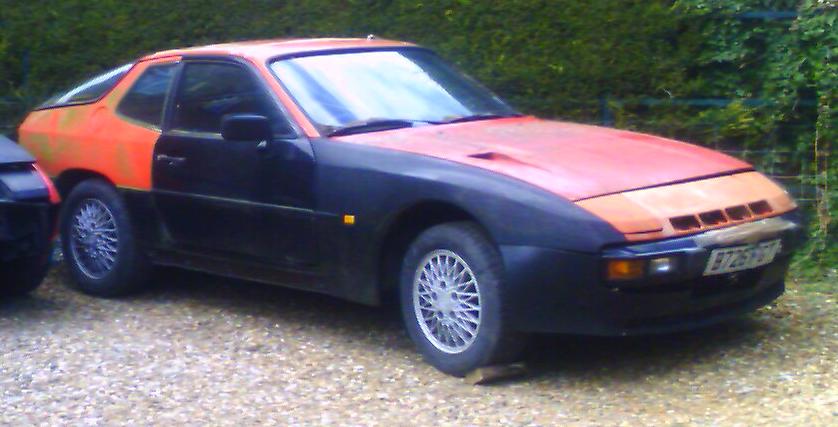

Sorry about the phone camera picture... but... I think I have close to the ultimate "rat look" 924 project... I'm thinking I will run it "as is", without so much as washing the lichen from it, for a while... maybe with a "my other car is concour" sticker!
It is, as it is, from necessity... It was a donor for the cabrio project, my 944 was written off and supplied the missing panels. The decent bonnet went on the cab, so it has the cabrio's old bonnet too. I don't have a suitable front bumper, hence the parcel tape until I find something better... What is important to me is how it feels to drive... if it is good, then I'll probably do something about the bodywork... if it isn't... it'll be in the "for sale" section.
