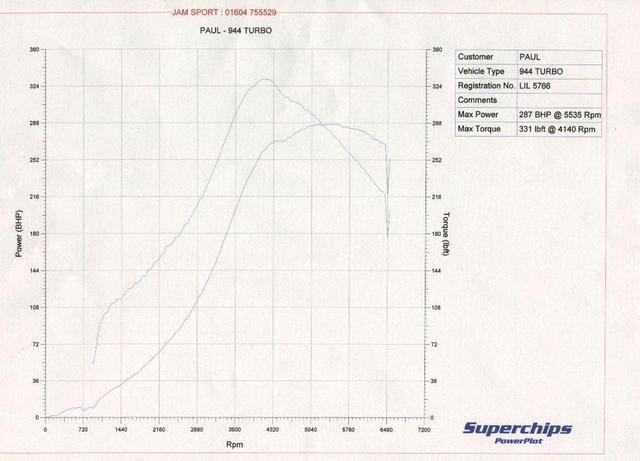

Paul do you have an RR graph i can have a look at?
Here is a pic of the RR graph. This was taken with the Guru kit and a 3mm WG shim installed and set to 15psi (1bar). I later discovered that the 3mm shim was not enough and the WG was starting to open at only 6psi (0.4bar) so I was still losing a lot of boost straight down the exhaust. I now have 9mm of shim in there [8D]

The Guru chips are fueled for 15psi (1.04bar) and I was running slighly rich according to the Dyno operator. I contacted Danno and he advised turning up to 16psi (1.1bar) to balance it out. This is where the cheapness of 'one chip fits all' is slighly inaccurate compared to a custom rolling road setup that costs £££££
I shan't be using the car in full WOT trackday action until I've gone back to the RollingRoad to check that I am not now too lean at 16psi
Mine ran 1.01bar so I should dig out my plot to look at it but from memory it made peak torque at 3,200 or something (but only 415Nm which is about 310lb/ft IIRC, so I'm not happy with that) and rising power to 280bhp @ 4,500 rpm then it drops because the wheels started to spin on the rollers.

Thanks Paul, i must say i am surprised the graph actually looks like the chip has pushed the torque curve slightly higer up the rev range. Especially at the bottom end, and it was here that i thought it would have shown slightly better numbers. The peak figs are fantastic. But the peak torque seems on a very very narrow band, standard the car produces 250ish lbft between 3800 & 4700 rpm.
p.s. i assume thats straight dyno power NOT at the wheels?
I think that is the difficulty with comparing graphs that are on different scales with one using metric the other imperial units [&:]. The Porsche graph starts at 1000rpm whereas mine starts from zero.
Looking at my paper copy which is more legible than the one I posted I can see that at 3800 the Guru chips yield 316 lbft and at 4700 they are at 308 lbft
It now makes 250 lbft all the way from 3200 to 5900, well actually it may be better than that as my wastegate now stays shut up to 5,500 rpm [:)] whereas in the graph it was opening at 4000 rpm [:eek:]
