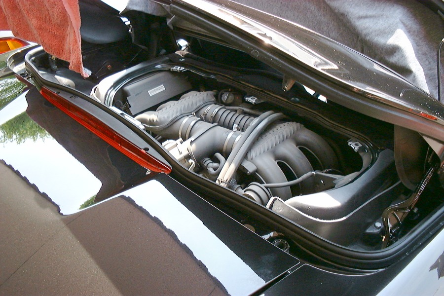

how many owners have even bothered to see what's under the 'clam shell'.
This for one thing.
[:D] Takes about 5 minutes on a good day.
This was taken about 5 years ago on the first occasion that I popped the lid but I can't for the life of me remember why I had a towel draped over the clamshell.
I do recall being totally underwhelmed by my first view of the top of the engine. It's just a pile of rubber pipes and plastic manifolds.

ORIGINAL: Mark Bennett
I think we've found a closet concours guy!
John, that engine compartment is far too clean [;)]
Mark, PDA sync gone wrong or just catching up on posts from Sept 2006 [;)]
