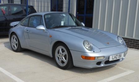

What is she, exactly?
M
She is a 94 Polar silver 993 C2, she has factory option tail and strangely a Turbo front? She is currently fitted with Targa Wheels but I am looking to change them for standard 993 alloys. You can see from the contrast between the new pic and the profile pic just how much the pigment fades over 19 years, couldn't believe how blue she is, and it was a Porsche approved facility @ AW repair group (Sleaford)
