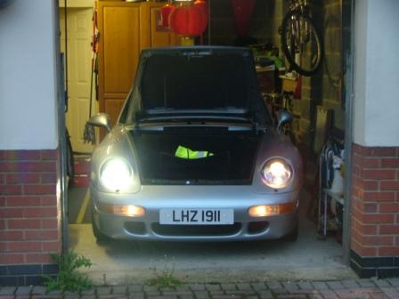

As previously reported, I fitted the HID kit on my dip beam headlamps. The kit arrived in 3 days, and took 20 minutes for one side, older style back plate and 10 minutes for the other side, newer style back plate with screw pegs. It was so easy, despite being a qualified engineer, it really was child simple.
The result is brilliant and so neat. I would strongly recommend them to anyone who hates night driving in a 993.
The picture shows one side completed, side lights LED's still to be done at that time. As previously suggested, I would strongly recommend correct setting up of the lights using a beam alignment tool. As the VOSA letter is full of "should and could" MOTshould not be a problem.
