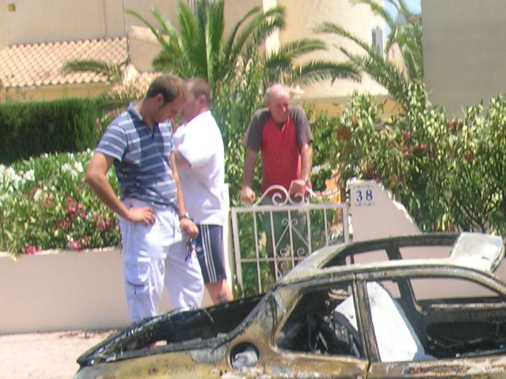

Not totaly unheard of. My 82 Lux caught fire 2 years ago in spain. Cause not known as car hadn't moved for 2 days after driving there.

Not too long ago there was a red Cabriolet being auctioned by a insurance salvage company. It had been written off by an underbonnet fire. There was an 18" diameter burnt patch smack bang in the centre of the bonnet, directly over the inlet manifold/injector area.
My 924 project was bought with underbonnet fire damage. Hard to tell what went first but it was in the wiring area under the servo and/or the fuel pipes in the same area. By the way, original Porsche PVC underseal burns VERY well indeed.
