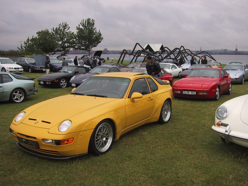

Here's a picture or two of the wide bodied look I prefer on the 944. I did consider doing it to my car, but figured you'd need a lot of power to pull it off convincingly, and rust between the fibreglass and the metal could be an issue, plus you would have to spend a lot on suitable wheels and tyres and ultimately it would become less useable on the road. If I had a track only car, could afford a custom set of BBS LM's and was running 500bhp+ then I'd go for it without hesitation.

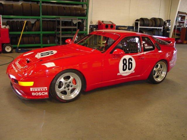

Alright Pal , I think my 8 year old son hit the nail on the head with the silver version of this GT2 944 look , he said it looks like it's made From tin plate and it's going to fall to peaces ,No doubt the owner has spent a fortune on this 944 to get it to this end result , but like some women who also spend a small fortune on cosmetic surgery , they don't always look to attractive !!! If it was in a different colour then it may look a total different car , and I had a look at the pic's on this topic today and noticed that huge GT style rear wing on the silver 944 !!! Over cooked Fast and Furious comes to mind !!! The yellow version looks really nice and very classy indeed , I have bought a full front splitter for my 944T and it cost £160 plus £60 to have it painted and I do like the Turbo 968 rear adjustable spoiler , but cost a small fortune , so the original also adds a lot of character to the 944 . Here are some pic's of my dream car that some day I will build , when the 968 come down a little in price , I am going to make a Turbo version of the 968 very rare the Turbo RS , wide enough for my liking and absolutely beautiful with the Turbo adjustable rear spoiler , front splitter ,cup mirrors , They have made a slot in the bonnet same as the 924 Turbo so the air goes straight into the air filter induction very nicely made indeed , I would say this is a perfect looking 968 , best regards J.C

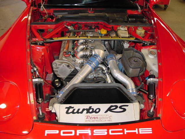

Not worked out how to upload two pic's in one posting so here is a pic of the engine bay on the 968 Turbo , [FONT=comic sans ms"]
Absolutely Devine , see the Air Induction kit attached directly to the Turbo so you get plenty of cold air in !!! work of art , if I popped the bonnet of my 944T and had this to show off , I would be the happiest man on the planet !!! Regards J.C[FONT=verdana,geneva"]
I've seen pics of that 968 before, it realy is stunning. There are some wonderful modified 968 racers out there. I hope you're able to build the car you want, it'd be such a great project. I still want to make a modern version of the 924 GTR, if I had the space I'd buy a shell now and start working on it [8|]

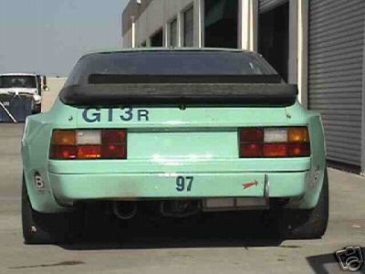

I think the main thing that lets Guns car down is the silver colour scheme, a flat red, blue or yellow would have been much better. I'm not sure if it's going to become an out and out racecar, but it would be more than a bit OTT for a street car IMHO. Most of the large arched, huge winged US cars are very powerful racecars that need wide tyres and big wings to compete with the more modern machinery in their race class.
One of the nicest widebody racecars I have seen belongs to a Dutchman called Hans who posts on Rennlist. It's a 1050kg Turbo with a 2.5L engine putting out 350bhp but he's building a 2.8L with a limit of 400bhp to meet his class rules

Secondly JC, the vents in the RS hood are for drawing hot air out, not cool air in. Cool air comes in through the vents in the nose cone, passes through i/c & rad, and then out through the hood into a low pressure area. Plus it's sealed from weather.

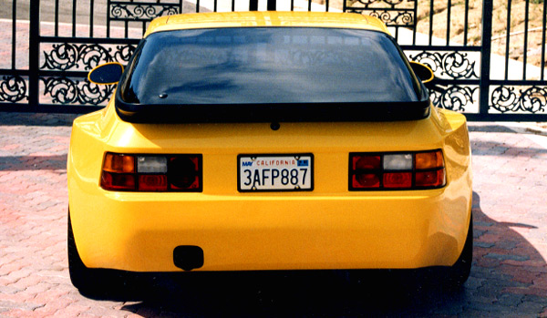

Peter, that Yellow 968 with the bolt on flares is Solo's car and I agree it does look pretty smart and within the boundaries of acceptable taste for a road/track car. The rear end shot of the other Yellow car shows another kit that you can purchase and is probably the best fitting kit commercially available, but that one piece bumper cover acts like a parachute and would not be suited to your pursuits. This from the guy who makes it.
